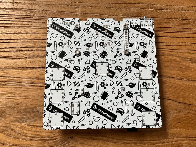

Hey @Karlgott,
You’ll need to fix some of the soldering joints for your Jay-D to work properly.
I’m adding photos of the soldering joints that need to be fixed here.

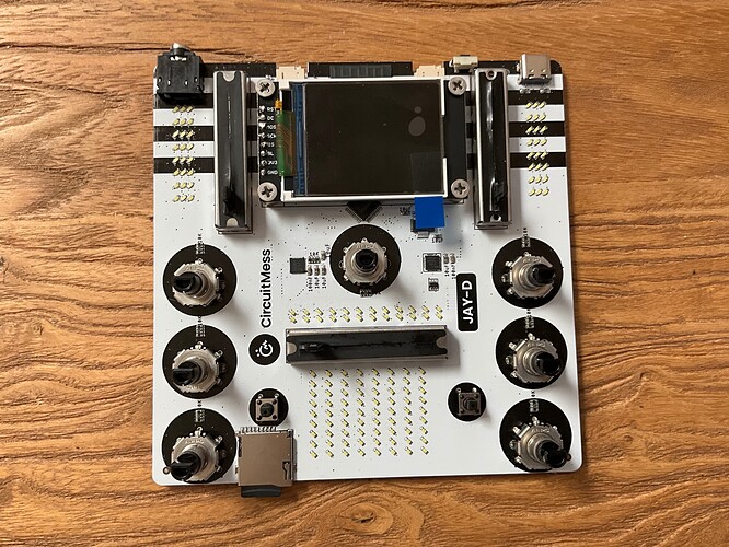

Hi, I’ve got the same problem, only my lights blink once plugged in and then nothing else happens, could you help me resolve the problem. Here’s some photos.
