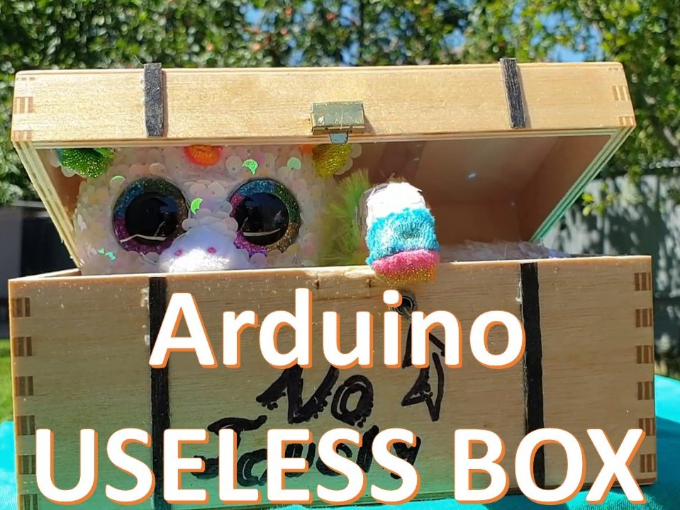

Would it be possible to repurpose a chatter 2 into the controller for a useless box?
It would be easy to replace a button with a SPST for an input.
But can button terminals be turned into outputs to control the servos?
What other sensors could we add via breakout boards?
