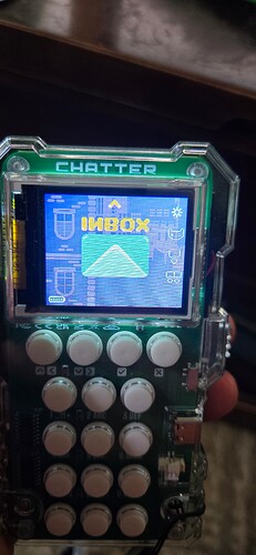

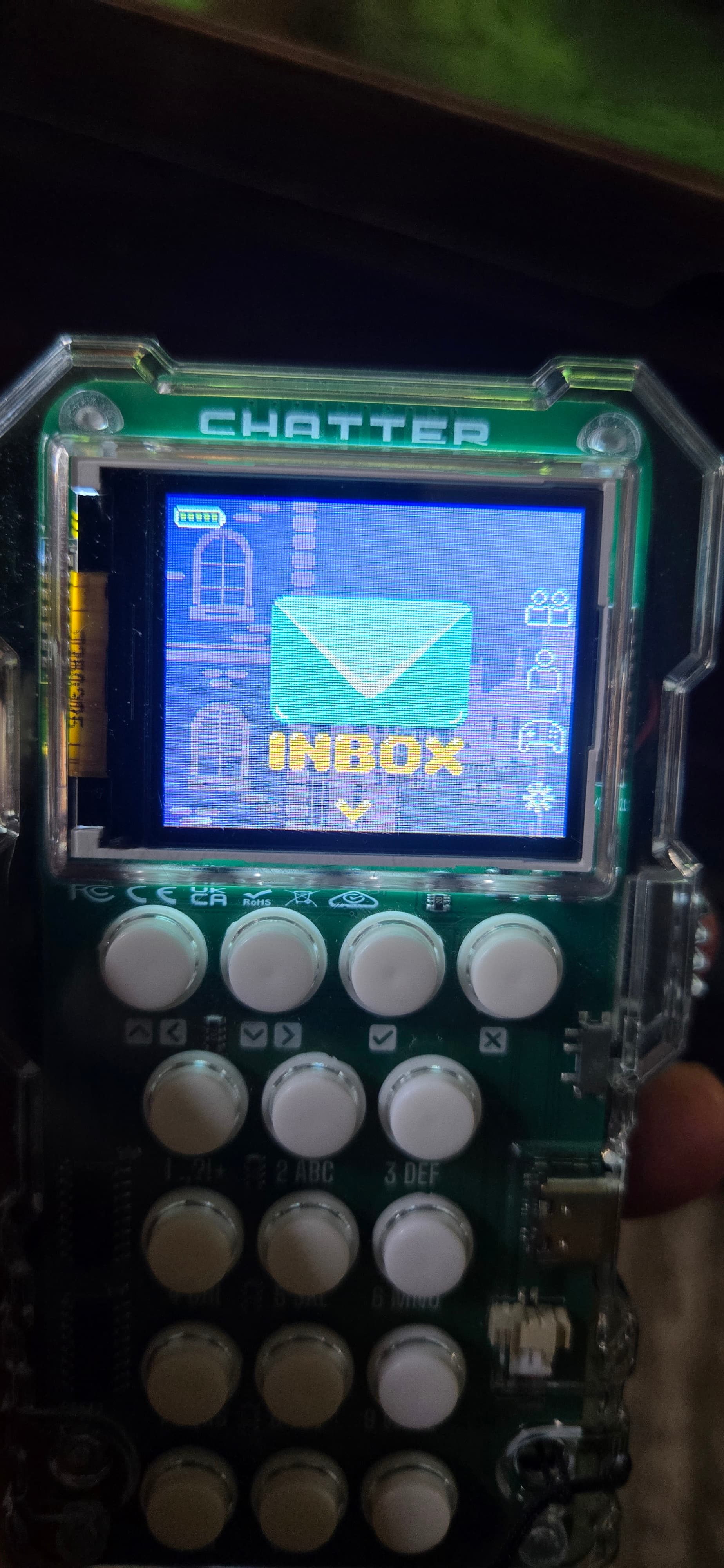

Hello there. Heres a couple pics of powerup and when it flips the display. Ive tried a firmware reset on the website but it is still the same.

Hi @Coryg,
Could you try sending the video to us via mail to contact@circuitmess.com?
Also thank you for the pictures and we’ll definitely investigate them further.

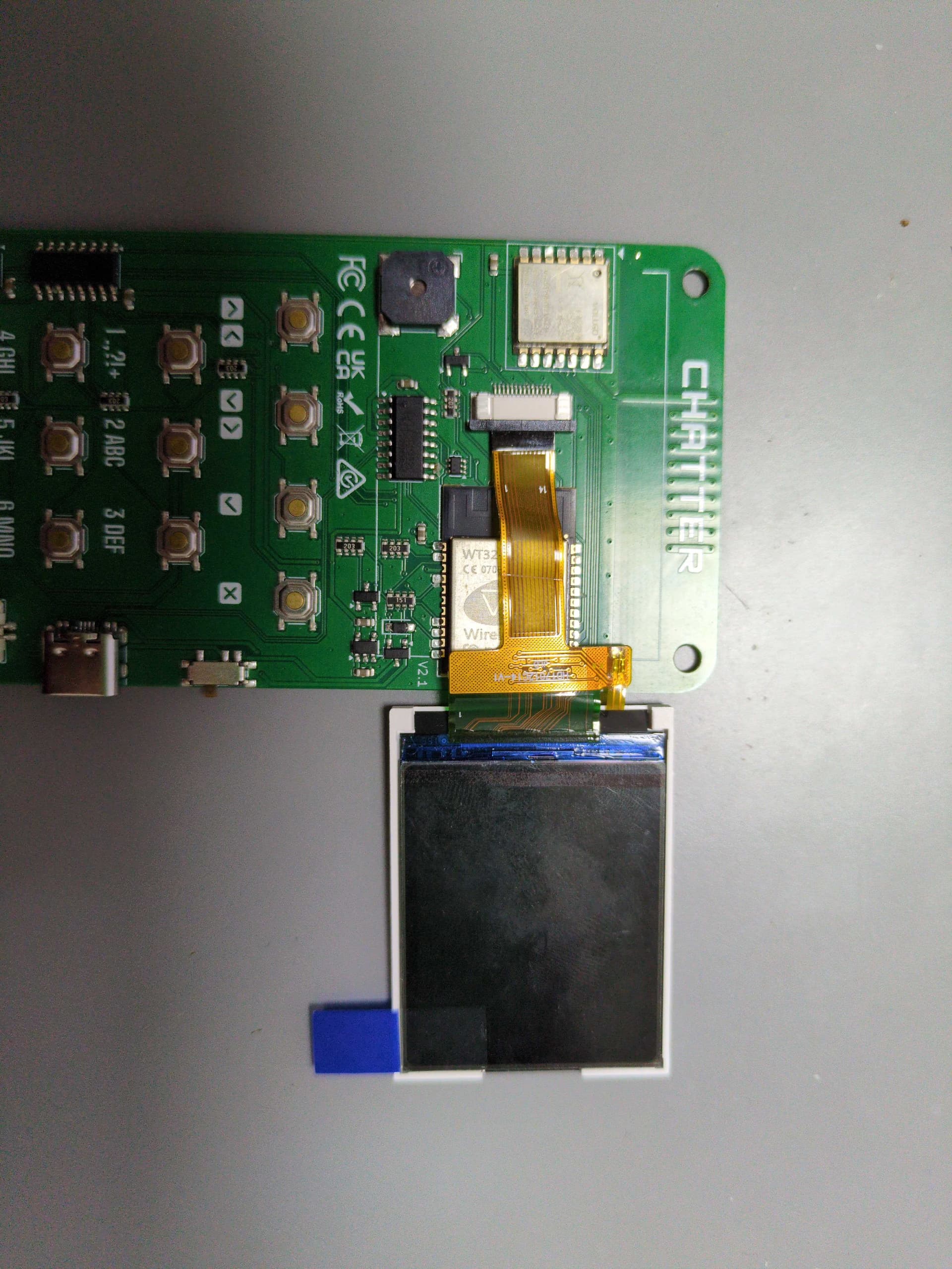

Hi, @Coryg,
In addition to the video, could you please also unscrew the device and send us a photo of both Chatters (the working one and the faulty one)? We’d like a picture similar to the one in the attachment, where the ribbon cable from the screen is clearly visible.
You can send all of that to us via mail to contact@circuitmess.com.
Thanks in advance.

Hi once again @Coryg,
It might help to carefully disconnect and then reconnect the ribbon cable to the connector to see if that resolves the screen issue.
If that doesn’t help, please reach us via mail (contact@circuitmess.com) with your order number and we’ll send you a replacement device.

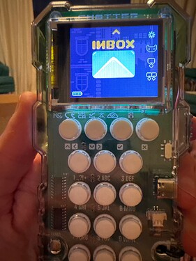

The same thing happens to one of my chatters (just purchased a couple of weeks ago).

Hi @AndLyle,
Thanks for reaching out.
Could you please send us an email via contact@circuitmess.com with your order number and this picture you sent here and we’ll definitely try to sort this out for you?
