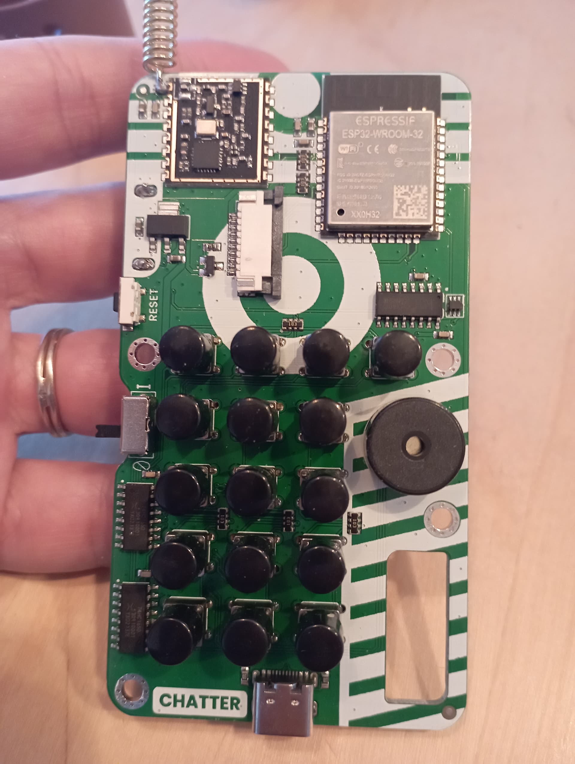

the usb connection is flakey. it connects, then disconnect
because of above, its hard to be productive workflow. too much time spent powering device on/off, reinserting cable, checking if /dev/tty.usb* is being used on ti, even rebooting entire computer
I think the main cuprit here is this thing drains the 3 AA batteries very quickly. So it can not maintain the minimal power it needs to maintain the USB connection
This means it requires batteries to run even when connected to usb. That is a design flaw in my view.
The product should run off usb so one can develop and deploy without worry of battery drain or life.
If i cant get even 1 hour of programming dev off 3 AAA, then the happy wow factors goes away very quickly.
Sorry. very frustrated at such an obvious need a user/dev would have - to run off regular usb without batteries and to dev while connected to computer with usb without batteries

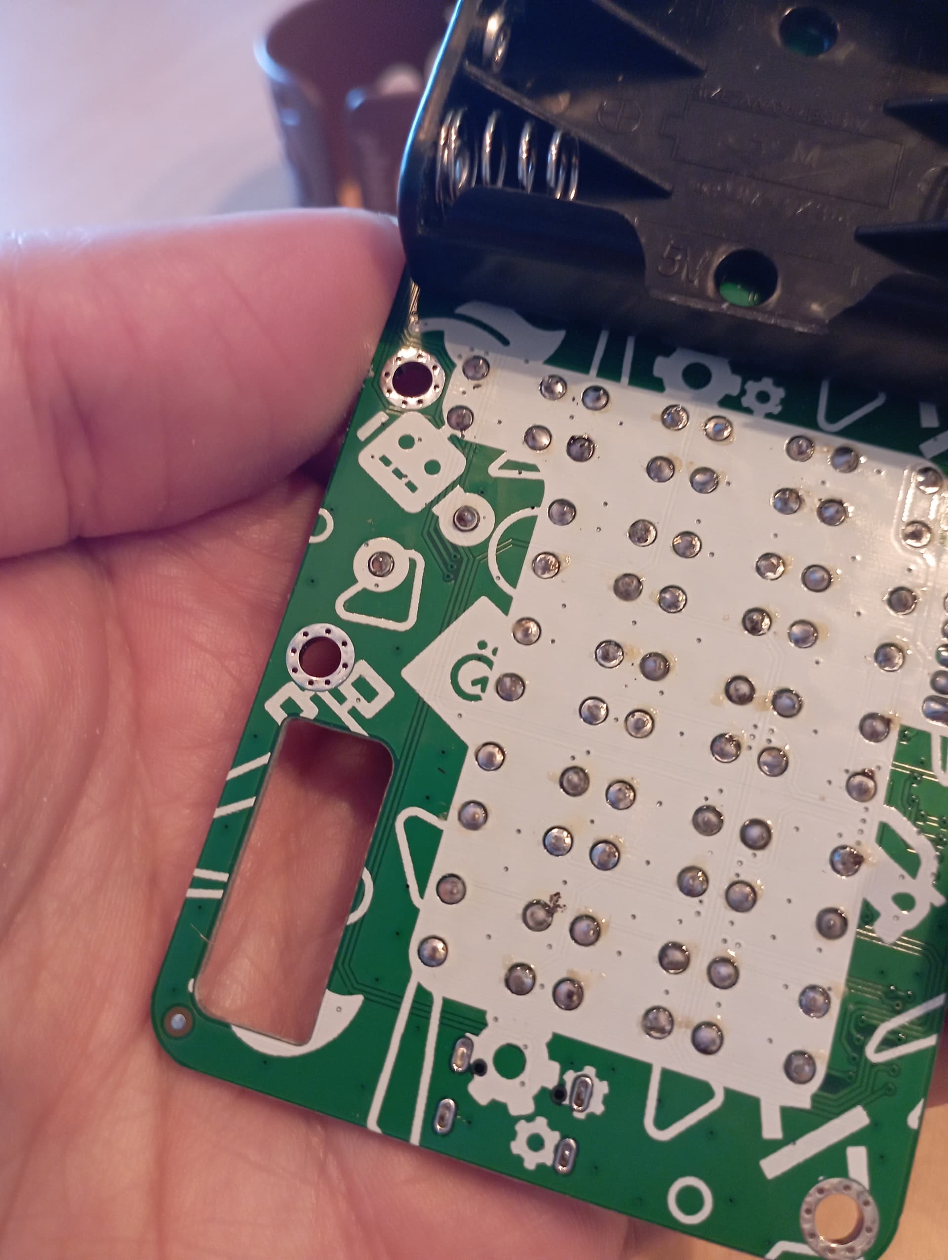

Hi there is a pretty simple hack to make it work off of usb power. on the back there is a testpoint 11 solder a wire to it and to the off terminal the top one on the switch. I used a red wire to make it blend in with the board which unfortunately makes it harder to see in the photo.
Hi @mog thank you for sharing. I was able to get mine done with some magnet wire and it is working great. I may redo it later with a shielded wire to avoid a short.
Came through the same âbattery frustrationâ as others, so yes, this tip is great.
