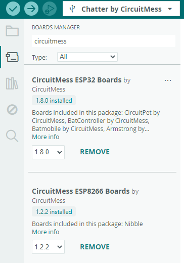

Hi there, I have to compile the code via IDE as the only legal bandwidth i can use is 923Mhz. However, there seems to be a lot of issues with the github files. I’m currently using the 1.7.5 version of the circuitMess esp32 board on the arduino IDE.
C:\Users\z_jia\Downloads\Chatter-Firmware-master\Chatter-Firmware\src\JigHWTest\JigHWTest.cpp:12:28: fatal error: ChatterDisplay.h: No such file or directory
compilation terminated.
exit status 1
Compilation error: ChatterDisplay.h: No such file or directory
So when I proceed to //ChatterDisplay.h the following chunk happens,

Hi @Area503,
Thank you for your patience.
Please update the Arduino CircuitMess ESP32 package to version 1.8.0 (see attached image), and download the new version of the Chatter firmware (either from GitHub or by downloading the new zipped v2.0 release from our GitHub page).
If you have any other questions, feel free to ask!
