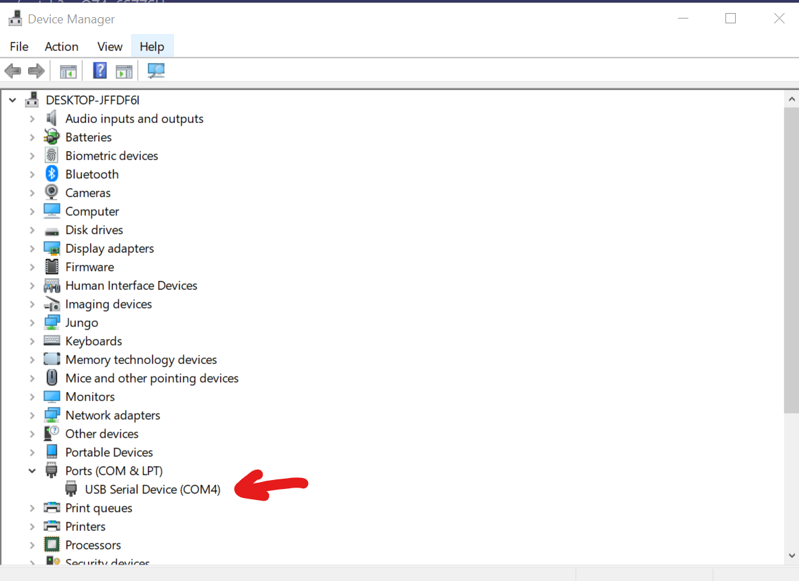

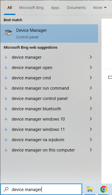

Could you please open Device Manager (see image 1) and check if there’s any available COM port (see image 2)? The COM port for the Bit won’t appear if the device is in sleep mode (auto-shutdown).

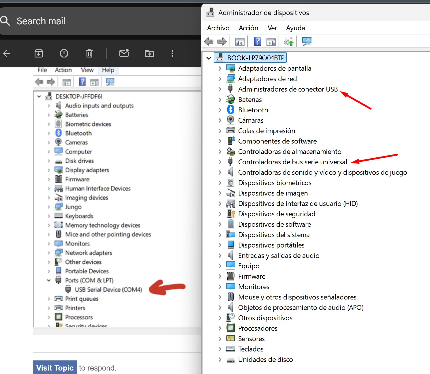

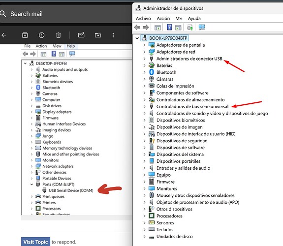

thanks for your help. I have checked the device manager and I cannot locate any USB Serial Device. Is that normal? Can I add one?
I will try with other computer if this setup is unable to support the BIT device.

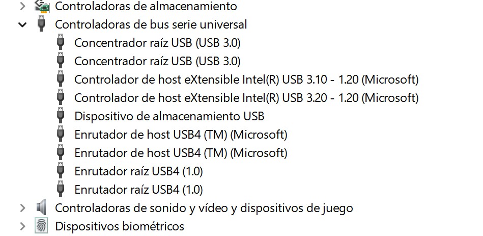

Check out also the USB serial controllers. (I cannot add two screenshots on a single reply)
