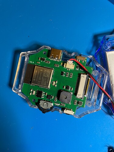

Hi @Ana_Prohaska -
Here is a photo of the board inside the watch.
