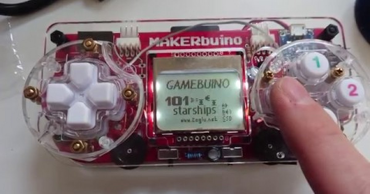

I thought of two different ways. Either to add the buttons by connecting with a cable or mounting a D Pad directly on the board and replace the pushbuttons.
For example cutting the area from a gamepad-board ( example: https://circuit-board.de/forum/index.php/Attachment/52572-image004-jpg/) with the D Pad and adding it on top of the existing area for the pushbuttons and then connect the wires to the existing lines on the board. Is that possible in theory? Or do i have to reconfigure all games and config-files?
It should be possible if you can figure out how the buttons on the gamepad-board are connected. Then you won’t need to reconfigure the games. Technically it’s possible to connect the new buttons but you’ll need to use the GND signal of the MAKERbuino.

Hey guys, today I made some progress. I cut the gamepad d pad pcb and also the top of the gamepad cover… Mounting on the lasercut will be a topic. But for now I will continue trying to keep the old screw domes. Let’s see, if it doesn’t really work out I will model a top cover in cad and then 3d print.
Hey today again some progress. As you might have noticed I was stopping the assembling process before even adding the clicky buttons. So now that the buttons are exchanged I can continue the overall assembling process before I can give feedback how the buttons work now. Until now I am very happy with the first look. Let’s see how it goes on…

Hey guys, i finally made it!
Here is the result of the Custom Buttons makerbuino project!
But some advice for those who might follow this idea: dont Short cable too much, be Patient while Customizing plastic parts!
