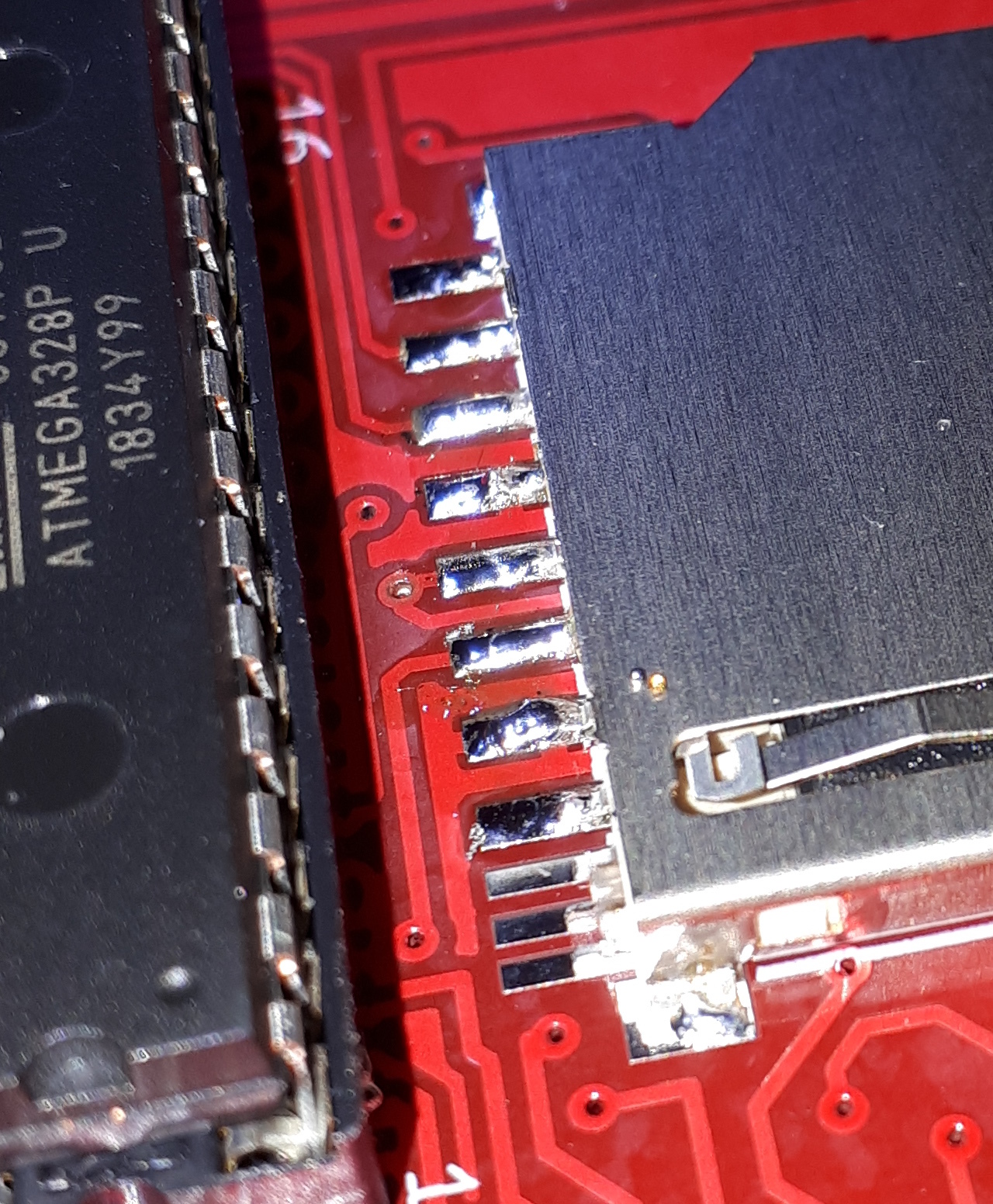

Hi Albert,
thank you for making Makerbuino and for your kind support.
Here are some images of the board (sorry for the ugly soldering):
Best regards,
Michael
Hey Michael,
Thank you for the photos!
Can you please resolder the contacts on the SD card socket and make sure that none of them are shorted?
Hello Albert,
ok, I tried that and hope it looks better now (see image below). Neither of them seem to be shorted.
Unfortunately, the problem persists.
Oddly, only the game menu (Is that the loader?) is showing garbage.
If I blindly select and start a game, it is being displayed perfectly.
