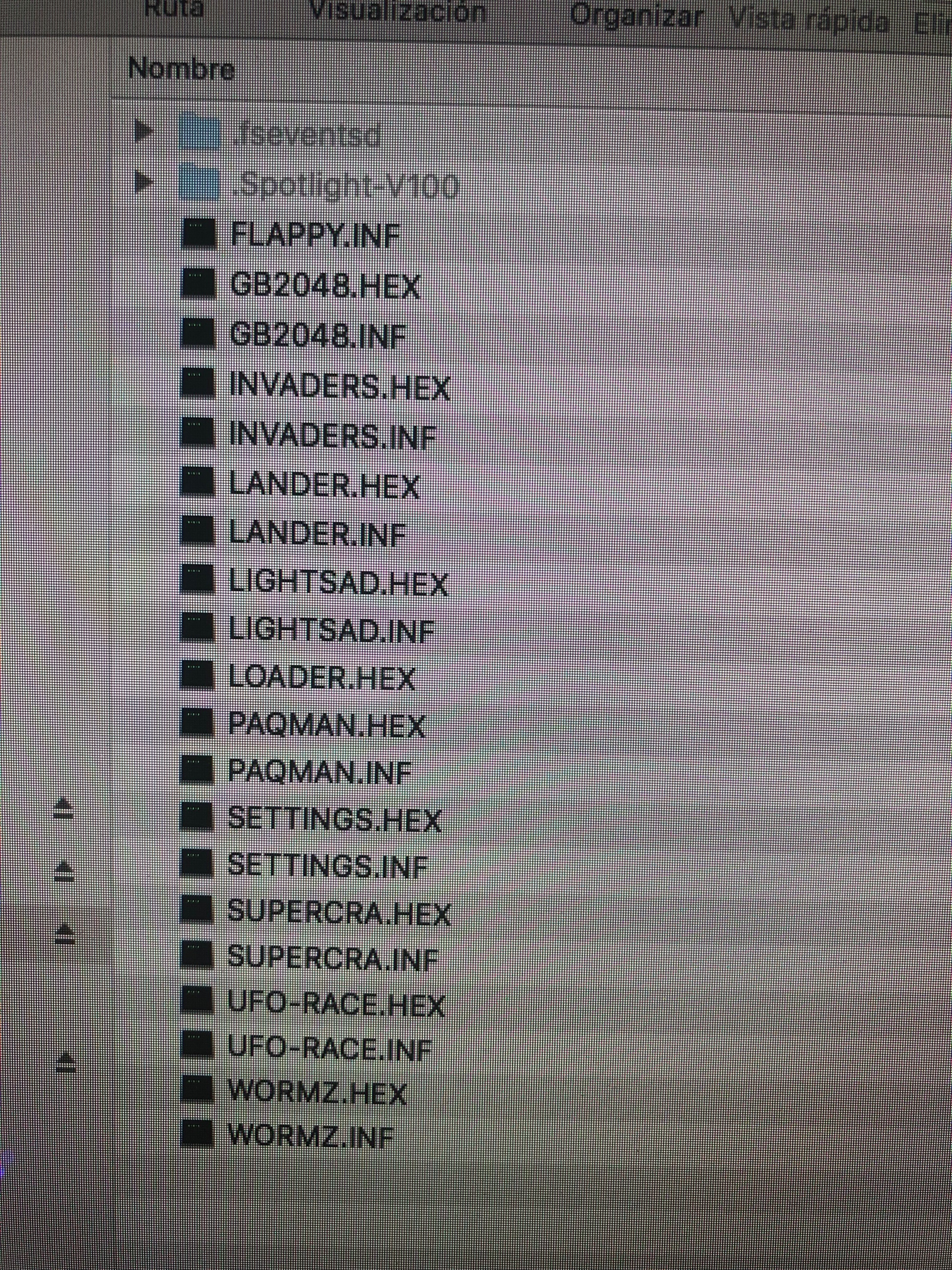

Good morning, I made a clone of the makerbuino following this manual https://www.instructables.com/id/Making-Makerbuino-Game-Console-From-Scratch/ I loaded the configuration menu etc β¦ but when I press βCβ to load the SD games it keeps loading hours and hours and does nothing, what could be the problem, thanks

- SD card - check if it has the required .HEX files on it and if they are in the root folder and unzipped. You especially need to have LOADER.HEX on the card in order for this to work
Thank you for your quick response, I understand that by not being made by you, you cannot give support, according to the author, it works perfectly for you, but I also miss something so simple that I cannot see. I attached some pictures, I understand that the bootloader is gambebuinoboot_hex or only.hex, I have tested both with the same result.

Thank you very much, in the end it was the memory card, which although I had also tried a 2GB was formatted to fat32, thank you thank you thank you β¦
